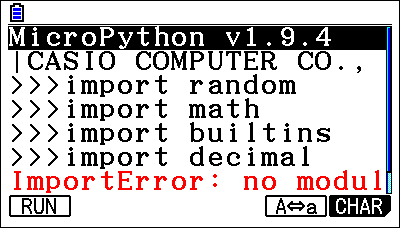

Does Python's built-in Decimal module work on the calculator?
On computer Python:
Code: Select all
>>> from decimal import Decimal as D
>>> D('2').sqrt()**2
Decimal('1.999999999999999999999999999')
>>> D('2').sqrt()**2-2
Decimal('-1E-27')
Still not quite zero... but at this point the error is so small you could use the round function to get zero. Unfortunate, but it's about the best you're going to get from Python. I guess this is where Casio Basic's exact values work better.

Unread postby critor » 02 Nov 2018, 10:04
Thanks, but unfortunately it's not yet available on the Casio fx-CG50 / Graph 90+E :

En effet, pas de module Décimal, ni Fraction pour le moment. Dommage.
