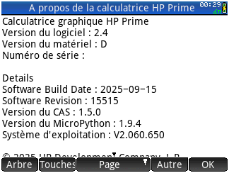

22873La version 2.4 constitue une mise à jour majeure de la HP Prime. Son objectif est de doter la calculatrice d'un moteur de calcul exact, et donc d'évacuer tout risque de résultat exact faux.
C'est donc une refonte en profondeur du fonctionnement de la calculatrice pouvant générer nombre d'anomalies, d'où la longueur de ce bêta-test.
Voici le changelog de la mise à jour 2.4 dans sa dernière révision 14599 :
Code: Select all
Date Released: 2025/09/09
Versions
               Firmware Version: 2.4 BETA (revision 15499)
This release introduces support for exact arithmetic involving fractions, possibly
multiplied by pi, over a limited range of rational numbers. The new numeric calculation
routines automatically switch to decimal arithmetic when numerators or denominators go
beyond the limited range (of approximately nineteen digits). Only some portions of some
numerical environments have been changed: these new routines are not used in CAS or Python
calculations, but can be used by calculations in the Home view, the Function app, or in
PPL programs.
Another notable change is that in areas where implicit multiplication is allowed, such as
within definitions in the Function app's Symbolic view, or in the Home view, the logic of
implicit multiplication has been reworked. Two examples being that "XYSIN(X)" is now
interpreted as "X*Y*SIN(X)" and "X(1+Y)" is now interpreted as "X*(1+Y)". The parsing
rules of the CAS have not been adjusted.
Details of changes follow below. Release notes are subject to adjustment during the beta
phase.

Nous y sommes. La mise à jour finalisée est sortie, version 2.4.15515 compilée ce 15 septembre 2025 :
Voici les liens de téléchargements à jour :
