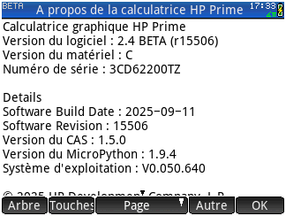

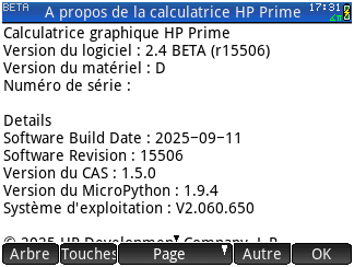

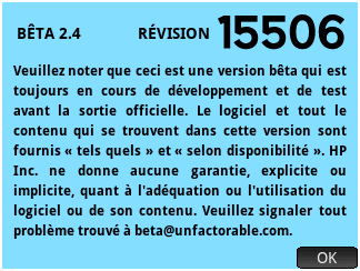

Une nouvelle bêta 2.4.15506 est disponible, compilée ce 11 septembre 2025 :
Voici le dernier changelog :
Code: Select all
               Firmware Version: 2.4 BETA (revision 15506)
This release introduces support for exact arithmetic involving fractions, possibly multiplied by pi, over a limited range of rational numbers. The new numeric calculation routines automatically switch to decimal arithmetic when numerators or denominators go beyond the limited range (of approximately nineteen digits). Only some portions of some numerical environments have been changed: these new routines are not used in CAS or Python calculations, but can be used by calculations in the Home view, the Function app, or in PPL programs.
Another notable change is that in areas where implicit multiplication is allowed, such as within definitions in the Function app's Symbolic view, or in the Home view, the logic of implicit multiplication has been reworked. Two examples being that "XYSIN(X)" is now interpreted as "X*Y*SIN(X)" and "X(1+Y)" is now interpreted as "X*(1+Y)". The parsing rules of the CAS have not been adjusted.
Details of changes follow below. Release notes are subject to adjustment during the beta phase.
