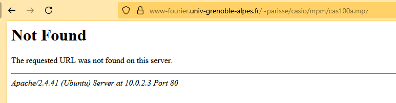

Hi! I was trying to install KhiCAS on my Graph Math+ following your instructions but i found myself in a bind when downloading the cas100a.msz and cas100b.mzs files for the english ver.
