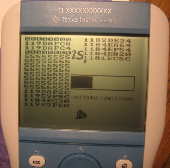

nLaunch passe au-dessus et s'attaque directement au Boot2, plus précisément dans sa version 1.4.1571 qui comporte une faille permettant l'exécution de code tiers:
1780

nLaunch makes it way by directly attacking the boot2, actually its version 1.4.1571, which contains a "loophole" for running third-party code:
1780
To use nLaunch, you must therefore begin by reprogramming your boot2 to version 1.4.1571, which is now very simple with nsNandMgr that came out not so long ago.
