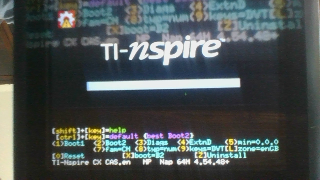

Hi, Please help me!
Can you help to look in the "DIAG": I have three "CTRLX" in the Flash partitions. In your picture, only have one "CTRLX" and one "DIAGS".
How can I delete the extra two "CTRLX"?
Thanks.

Hi, I find another problem.
after installing OS 4.5.4 and Ndless, The Calculator becomes ALWAYS reboot itself.

Unread postby critor » 23 Apr 2021, 20:52
Hi.
Having several ControlX images shoudn't be an issue.
Only the 1st one is going to be launched anyway.
When does the calculator reboot ?
If you didn't update the Ndless files to the ones supporting before installing OS 4.5.4, then Ndless auto installation on boot is going to crash the calculator.
In this case, you can :
  1. call the ControlX menu and reset the minimal OS version with
    5
  2. hold
    doc
    enter
    EE
    while resetting the calculator to call the maintenance menu (if don't get the maintenance menu, you'll have to reperform the previous step)
  3. select
    2
    to remove the OS
  4. reinstall an older OS version
  5. update the Ndless files on your calculator
  6. reinstall OS 4.5.4
