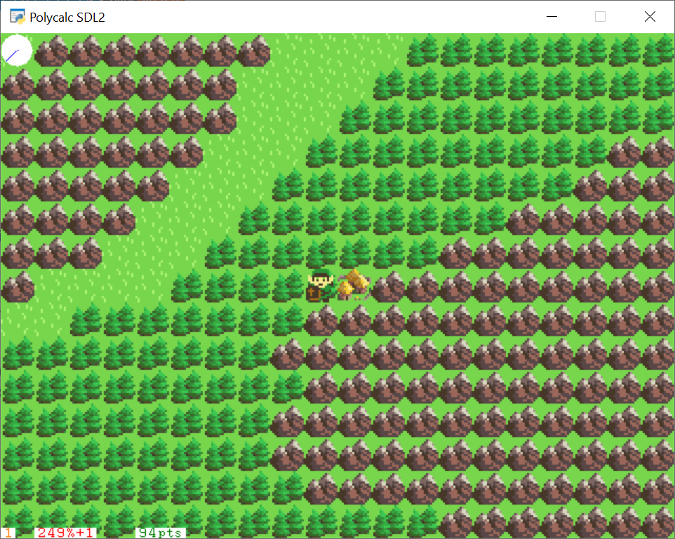

I've ran into a bit of an issue using manual mode on the computer. When I have the compass turned (supposedly) at a diagonal (as apposed to UP, DOWN, LEFT, RIGHT) sometimes when I press a key to go forward, rather than moving me in that direction, I end up going differently. For example, the compass is facing south-east but I go south, or facing north-west and I go west. It seems to happen regardless of the things around me as well.

It's perfectly normal.
The view can only put the player on a tile.
Even if you've got the impression of having moved north then west, internally you actually moved according to a straight line.
The manual mode was only designed for testing. Feel free to modify it to suit your needs. :)

Bon j'ai pris quelques instants pour tester ça sur PC, ça ne marche pas.
Thonny ne veut pas :
ImportError: could not find any library for SDL2 (PYSDL2_DLL_PATH: unset)
Spyder pas mieux :
Bien évidemment, j'ai fait l'installation de SDL comme demandé :
pip install PySDL2
Requirement already satisfied: PySDL2 in c:\users\micro\anaconda3\lib\site-packages (0.9.9)
Note: you may need to restart the kernel to use updated packages.
Puis
Console > restart Kermel dans spyder sans succès.

Bon j'ai trouvé, il faut faire ça :
pip install pysdl2-dll
pip install -U pysdl2
Source
ça marche maintenant
