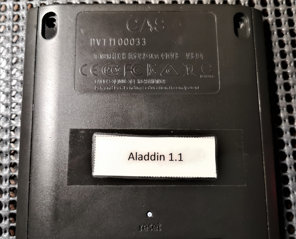

  7. TI also deviates from the nomenclature for prototypes, opting instead for more meaningful serial numbers such as "P3-ASIC-DVT1.2 0318", or sometimes no serial number at all.
