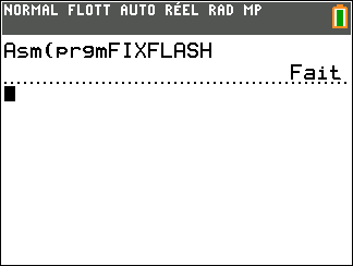

Utilitaire permettant de réparer les mémoires d'archive TI-83 Premium CE et TI-84 Plus CE corrompues par l'utilisation combinée du jeu 2048 CE et de la bibliothèque fileioc 2.4 des CE C Standard libraries.
Nécessite bien évidemment que la calculatrice soit encore en état de marche...
- désarchive les variables affectées encore accessibles
- supprime les variables affectées inaccessibles
"This fixes the corruption caused by older versions of the C FileIO library. If a C program that uses the FileIO library to archive variables is run, the calculator may freeze next time a reset occurs, and this program can be used to prevent that. When you run this program, it will delete inaccessible corrupted variables (ones that don't even show up in the mem menu) and it will unarchive accessible ones. After running this program, these vars can be safely rearchived from the mem menu. If there is not enough free ram to unarchive all of the corrupted variables, you will get an ERR:MEMORY, and you can just rerun the program after freeing up some ram (e.g. after rearchiving some of the unarchived variables)."
