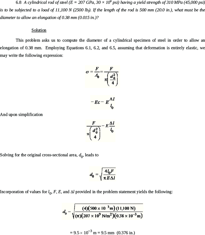

6.8 A cylindrical rod of steel (E = 207 GPa, 30 × 106 psi) having a yield strength of 310 MPa (45,000 psi)
LVWREHVXEMHFWHGWRDORDGRI1 OEf ,IWKHOHQJWKRIWKHURGLVPP LQ ZKDWPXVWEHWKH
GLDPHWHUWRDOORZDQHORQJDWLRQRIPP LQ "
Solution
This problem asks us to compute the diameter of a cylindrical specimen of steel in order to allow an
elongation of 0.38 mm. Employing Equations 6.1, 6.2, and 6.5, assuming that deformation is entirely elastic, we
may write the following expression:
And upon simplification
Solving for the original cross-sectional area, d0, leads to
Incorporation of values for l0, F, E, and 'l provided in the problem statement yields the following:
3
= 9.5 u 10 m = 9.5 mm (0.376 in.)
