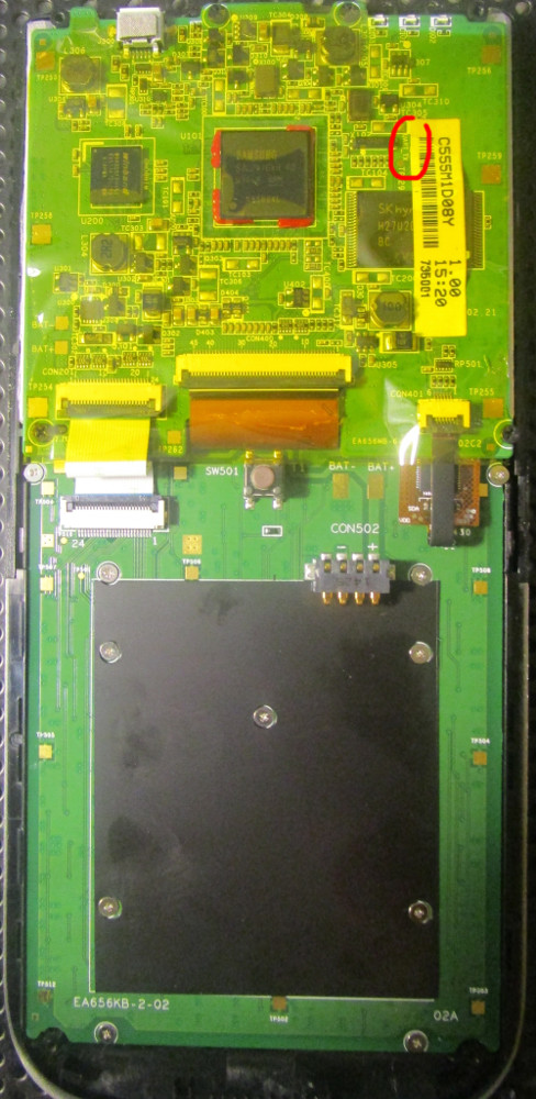

compsystems wrote:> .. As native development on the HP Prime requires ripping open said calculator and soldering a few wires to access the UART
>> please can include images of pin RS232 connection
Thanks
The pads (UART_RX, UART_TX) are labeled on the motherboard, BAT- can be used for ground. On the revision A hardware they are located to the right of the SoC chip, on the revision C hardware they are located above the NAND chip.
Unfortunately I kinda sprayed hot glue all over the place to prevent the wires from ripping out the pads, so aside from a big patch of glue you wouldn't see much. If you have trouble finding the pads, let me know which revision hardware you have. If it's revision A I can highlight the pads on a picture from the web ; if it's revision C I'll need you to post a picture of your motherboard since I can't find one on the web.
Also, please take note that this is not RS232, it's 3.3v TTL. You'll fry the UART and possibly more if you directly hook up a PC serial port to the HP Prime.

Here are the locations of the UART pads.
HW-A :
HW-C :
