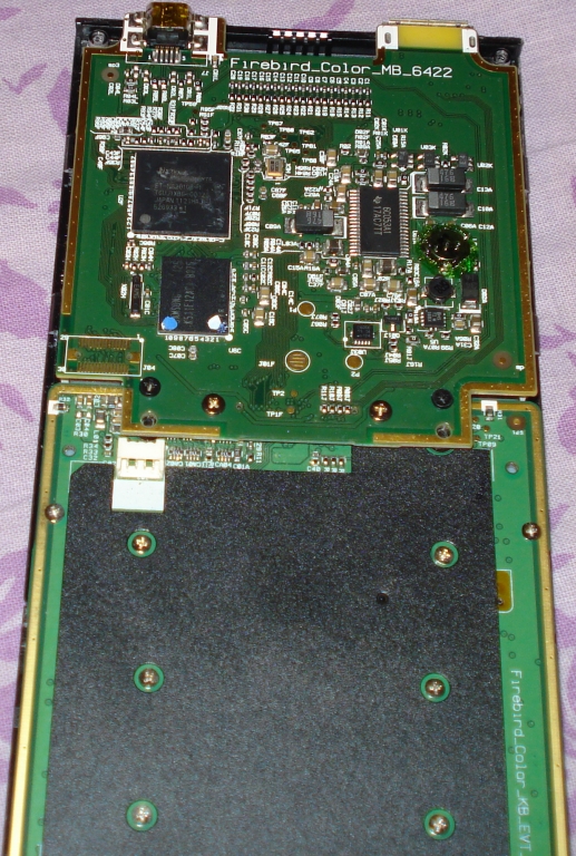

Before the release of the first TI-Nspire, the TI-Nspire ClickPad for back to school 2007, Texas Instruments freely distributed numbers of prototypes during the 2006-2007 schoolyear. I do not know what their lucky owners told TI, but I guess they didn'r really appreciate the gift as many of them rushed to resell it online after the release of TI-Nspire, but of course with a price similar to the production models one. A trained eye will notice several small differences, but the only one common to all prototypes is the mention of an 'EVT', 'DVT' or 'PVT' code in the serial number on the back. :mj:
15791301Until the release of color TI-Nspire CX for back to school 2011, online resale shops have been flooded with prototypes apparently very similar with the production models. But even if we put aside the dubious morality of this behaviour, it was nothing more than a monstrous scam! Indeed, prototypes Boot1 and Boot2 validated the signatures with the development keys and not the production ones. As a result:
  • These prototypes refused to install any OS released on the official TI website. And As TI doesn't release development OSes it was impossible for you to update the prototypes which remained stuck on old 1.1 and 1.2 versions! :mj:
  • If you had the bad idea to remove the OS via the maintenance menu, your prototype became unusable because no released OS could be installed on it! :mj:
Fortunately, TI-Planet has taken this cause to heart and tried its best to repair the scams you experienced.
  • We began first by recovering several functional prototypes from which we could extract some development OSes, allowing you to repair prototypes which had their OS removed! :bj:
  • Then, we noticed on these prototypes that the NOR chip hosting Boot1 was not write-protected. After many months of hard work, we finally proposed you a tutorial based on a Boot1 reflashing in order to transform your TI-Nspire ClickPad DVT prototypes into production models, allowing you to finally install the latest production OSes available at ti.com! :bj:
However, the ASIC chip on TI-Nspire ClickPad DVT prototypes doesn't include the non-CAS / CAS identification code. The NAND chip being flashable, a simple modification of its CAS / non-CAS code allows for example the transformation of a non-CAS prototype into a CAS one. This implies that the historical CAS / non-CAS checks are based on differences tests. The code in the ASIC chip being neither CAS nor non-CAS, the test is successful in all cases. :bj:
So for months and now years, you've been able to use your TI-Nspire ClickPad DVT prototype as a production model. Unfortunately, you can't anymore. The OS 3.6 freezes at startup on all TI-Nspire ClickPad DVT prototypes, even those whose CAS / non-CAS NAND case has never been changed! :o
So it seems that the new CAS / non-CAS verification on the startup of OS 3.6 was not coded in the same way as the historical verification, using tests of equalities and not differences! In consequences, ASIC verification fails on all these prototypes since there is no CAS or non-CAS code in the ASIC! :mj:
This raises some questions about the process of development. Does this error means they do not even test development versions of their new OS on TI-Nspire ClickPad / TouchPad anymore and simply generate them automatically? Or was this change intended to prevent students using six years old non-CAS prototypes turned into CAS ones during exams? It would be really extreme, but not surprising in the context of what we have been experiencing during the last months...
Do you think you simply have to reinstall an earlier version of the OS to repair your prototype? It would have been too easy... Although stuck at the grey screen, the OS 3.6 still has the malice to increase the minimum installable OS version stored in NAND... to 3.6! The only OS that you now have the right to install is the 3.6 which won't work! Your calculator is now unusable... TI just destroyed you rare TI-Nspire ClickPad DVT prototype without warning! :mj:
Note that the tool Nlaunch, even if it can't make OS 3.6 work on these prototypes, has the advantage of avoiding their bricking when attempting to use OS 3.6, since it makes Boot2 ignore the minimum installable OS version programmed in NAND.
In addition to the ones you may have purchased online, we distributed many of our TI- Nspire ClickPad DVT prototypes, either to developers or to our contests winners, and so we have to warn you:
DO NOT INSTALL OS 3.6 ON A TI-NSPIRE CLICKPAD DVT PROTOTYPE - STAY WITH OS 3.2 OR OLDER
There is so far no way to use the OS 3.6 on these prototypes; it is useless to try, even with Nlaunch.
If it's already too late for you, the general idea to ​​repair follows the pattern below:
  • if your boot2 is 3.0.1, reflash Boot2 1.4 using an external RS232 interface
  • remove the minimum installable OS version using the DowngradeFix tool
Feel free to answer in this topic if needed - we'll try to help everybody.

Avant la sortie des toutes premières TI-Nspire, les TI-Nspire ClickPad pour la rentrée 2007, Texas Instruments a distribué gracieusement nombres de prototypes en 2006-2007. Je ne sais pas ce que leurs heureux possesseurs ont dit à TI, mais il faut croire qu'ils n'avaient pas vraiment apprécié le cadeau puisqu'ils sont nombreux à s'être empressés de le revendre en ligne après la sortie des TI-Nspire, et bien évidemment à un prix similaire à celui des modèles de production. Un oeil averti remarquera plusieurs petite différences, mais la seule semblant être universelle est la mention d'un code 'EVT', 'DVT' ou 'PVT' au dos dans le numéro de série. :mj:
15791301Jusqu'à la sortie des TI-Nspire CX à écran couleur pour la rentrée 2011, l'offre de revente de TI-Nspire en ligne a donc été inondée de prototypes ressemblant à s'y méprendre au modèles de production. Or, même si l'on met de côté la moralité douteuse de cette démarche, il s'agissait ni plus ni moins d'une monstrueuse escroquerie! En effet, les Boot1 et Boot2 des prototypes vérifient les signatures avec les clés de développement et non celles de production. En conséquence:
  • Ces prototypes refusaient donc d'installer les OS distribués sur le site officiel de TI. Comme de plus TI ne distribue aucun OS de développement, il vous était donc impossible de mettre à jour ces prototypes qui restaient coincés sous d'antiques versions 1.1 ou 1.2! :mj:
  • Et si vous aviez la mauvaise idée de retirer l'OS via le menu de maintenance, votre prototype devenait inutilisable puisque plus aucun OS ne pouvait être installé! :mj:
Heureusement, TI-Planet a pris cette cause à coeur et a tout oeuvré pour réparer les escroqueries dont vous aviez été victimes.
  • Nous avons dans un premier temps récupéré à nos frais des prototypes fonctionnels dont nous avons pu extraire quelques OS de développement, vous permettant ainsi de remettre en état de marche des prototypes sans OS! :bj:
  • Par la suite, nous remarquions sur ces prototypes que la puce NOR accueillant le Boot1 n'était pas protégée contre l'écriture. Après des mois de travail acharné, nous te proposions enfin un tutoriel basé sur la reprogrammation du Boot1 afin de transformer tes prototypes TI-Nspire ClickPad DVT en modèles de production, te permettant enfin d'installer les derniers OS de production publiés sur le site de TI! :bj:
Or, la puce ASIC de ces prototypes TI-Nspire ClickPad DVT ne comporte pas le code d'identification CAS/non-CAS. La puce NAND étant reprogrammable, une simple modification du code CAS/non-CAS en NAND permet par exemple de transformer un prototype non-CAS en CAS. Cela implique que les vérifications CAS/non-CAS historiques sont basées sur des tests de différences. Le code inscrit dans la puce ASIC n'étant ni CAS ni non-CAS, le test réussit dans tous les cas. :bj:
Depuis des mois ou des années, vous avez donc pu utiliser votre prototype TI-Nspire ClickPad DVT comme un modèle de production. Ce n'est plus vrai désormais. L'OS 3.6 se bloque au démarrage sur l'écran grisé sur tous les prototypes TI-Nspire ClickPad DVT, même ceux dont le code CAS/non-CAS en NAND n'a jamais été modifié! :o
Il semble donc que la nouvelle vérification des codes CAS/non-CAS en NAND et ASIC au démarrage de l'OS 3.6 n'ait pas été codée de la même façon que la vérification historique, utilisant des tests d'égalités et non de différences! En conséquence, la vérification ASIC échoue sur tous ces prototypes puisqu'il n'y a ni CAS ni non-CAS dans l'ASIC! :mj:
On peut donc s'interroger sur le processus de développement chez TI. Est-ce que cette 'erreur' veut dire qu'ils ne testent même plus les versions de développement de leurs nouveaux OS sur TI-Nspire ClickPad/TouchPad et se contentent de les générer automatiquement? Ou est-ce que cette modification était voulue pour éviter que des candidats n'utilisent aux examens des prototypes non-CAS transformés en CAS? Ce serait vraiment extrême, mais non surprenant dans le contexte de tout ce que nous subissons ces derniers mois...
Il suffit de réinstaller une version antérieure de l'OS pour remettre le prototype en état? Pensez vous! Même bloqué à cet écran, l'OS 3.6 a quand même eu la malice de monter la version minimale d'OS installable inscrite en NAND à... 3.6! Le seul OS que vous avez le droit d'installer désormais est le 3.6 qui ne marche pas! Votre calculatrice est désormais inutilisable... TI vient donc de détruire sans prévenir votre rare prototype TI-Nspire ClickPad DVT! :mj:
Notons que l'outil Nlaunch, même si il ne permet pas d'utiliser l'OS 3.6 sur ces prototypes a toutefois l'avantage d'éviter leur destruction en cas de tentative d'utilisation de l'OS 3.6, puisque faisant ignorer au Boot2 la version minimale d'OS installable programmée en NAND.
Outre ceux que vous avez éventuellement achetés en ligne, nous avons redistribué nombre de nos prototypes TI-Nspire ClickPad DVT, soit à des développeurs, soit à des gagnants à nos concours, et nous nous devions donc de vous avertir:
VOUS NE DEVEZ PAS INSTALLER L'OS 3.6 SUR UN PROTOTYPE TI-NSPIRE CLICKPAD DVT - RESTEZ AU MAXIMUM AVEC UN OS 3.2!
Il n'y a à ce jour aucun moyen d'utiliser l'OS 3.6 sur ces prototypes, c'est inutile d'essayer, même pas avec Nlaunch.
Si c'est déjà trop tard pour vous, l'idée générale de réparation suit le schéma suivant:
  • si votre Boot2 est le 3.0.1, reprogrammation du Boot2 1.4 à l'aide d'une interface RS232 externe
  • suppression de la version minimale d'OS installable à l'aide de l'outil DowngradeFix
N'hésitez pas le cas échéant à répondre à ce sujet - nous vous dépannerons au cas par cas.
