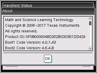

parrotgeek1 wrote:> patch its version to 4.6.4.8
That is supposed to be 4.4.0.8. Oops.
That's what I'm getting :
Note Boot2 version format isn't raw if I remember well.
But it might be some corruption too ?...
