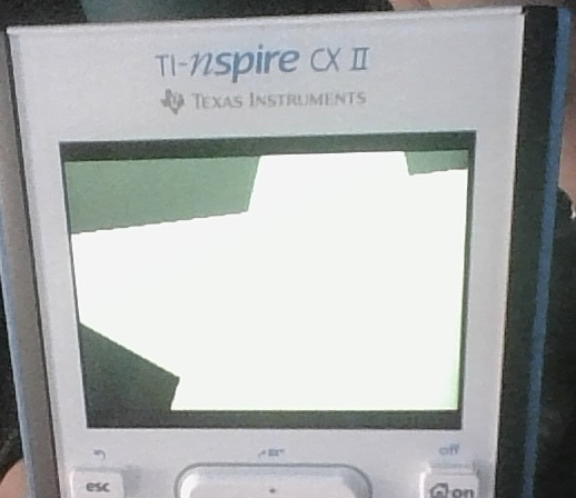

Unread postby RuralAnemone » 17 Nov 2020, 21:12
I get this too, as well as in Mario & Luigi Superstar Saga, when I'm about to enter a battle, the game freezes at this frame, which I think is the frame where the battle is loaded:
