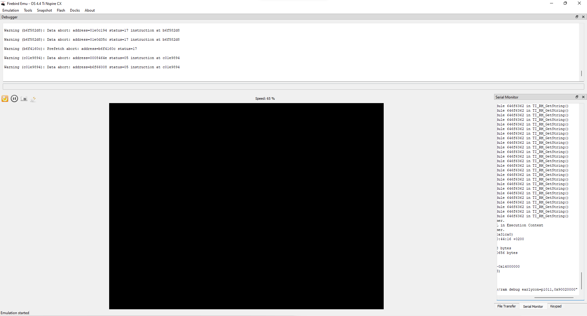

Unread postby SuperXX » 30 Sep 2021, 12:59
Vogtinator wrote:For some reason I thought that your calc was also a CX II, which is why I suggested to try a CX II DTB with USB disabled. Your calc is a CX (I) though, where USB host mode should actually work (at least it did in the past). USB initialization should also happen later than the console initialization.
No problem, that explains why I wasn´t really understanding what were you saying at first and I started to think that the USB has direct impact with screen issues. Nevermind, but at least thank you for the explanation for the CX II.
The great news is that you were able to reproduce the issue within firebird, that makes debugging much much easier! The "Warning: Bad read_word: 90140020" means that you're using a DTB for the CX II, which is not quite compatible. At least here (OS 4.2 HW-W in FB) it still gets to the console even with the wrong DTB though. I tested with the various files downloaded from the locations you mentioned, so the setup should be fairly close.
Actually any .dtb targeted for the nspire cx also gives the problem, that why I searched for HW-W screen issues, because I already knew that the screen from HW-W was different then the HW-Y and anything above W and found this issue (https://github.com/tangrs/nspire-linux-loader2/issues/7#issuecomment-840887756) which I downloaded the archive.zip and tried the nspire-cx.dtb and the nspire-cxII.dtb but they both have the same outcome and other nspire-cx.dtb I tested gave it too like this one: https://tiplanet.org/nspire-linux-builds/devicetree/nspire-cx.dtb
Another difference I can spot is that for some reason linuxloader2 does not print the commands it's executing to the serial console. It should look like this:
That I know why, I opened linuxloader and inserted the commands manually. For some reason my start_initrd.tns does this:
Which really doesn´t make sense, because if I manually execute them it works. But ok, for now I´ll ignore this.
What you can try next to get some output from the kernel in firebird is to use
CODE JAVASCRIPT : SELECT ALL
cmdline root=/dev/ram debug earlycon=pl011,0x90020000
in the ll2 script.
Ok so now the screen gets black but the debugger as more info, I´ll leave the .txt´s as an attachment
On your CX (I), did you edit start_initrd.ll2.tns to use the correct path to the DTB file? By default it uses dtb.tns as filename, not nspire-cx.dtb.tns. Having no DTB or a broken one would explain the boot failure.
I´ve edited the name of the file to nspre-cx.dtb.tns and it´s in the linux folder, so I think it´s ok. And it says it loaded the .dtb so I think it´s working

Unread postby Vogtinator » 30 Sep 2021, 17:40
Which is somewhat true - USB can cause issues during boot. Normally an error message is visible though.
Ah, ok.
That happens when using a Windows editor to edit text files. Those use incompatible line endings (CRLF instead of just LF). Try using an editor which supports "Unix" line endings.
in the ll2 script.
Those messages mean that it actually booted until the login prompt! There should be more on the serial console, but you can try cmdline root=/dev/ram debug console=tty0 anyway.
Sounds good.
I should also mention that even when the kernel boots fully and the console is visible, the generic nspire-cx.dtb does not contain the matching information for the LCD of HW-W+ calcs, so it'll be distorted and look a bit like "snow" on the black background. Should be clearly distinguishable from the random color bars though.
Uhm, so where can I find a .dtb for my calculator? All of them just say nspire-cx.dtb and all of the ones I tested didn´t worked.
And thank you once more for your help of course.
IIRC I saw one floating around at some point, but no idea where that was. It's basically just copying the LCD section from the CX II DT into the CX one and adjusting the rotation. For now let's try to get it to boot at all first...

Re: Screen Issues and more-linux Ti Nspire CX revision Y
Unread postby SuperXX » 30 Sep 2021, 19:44
I was using Notepad++ so that explains it. Now I created with Ubuntu and it´s working
Ok, I did that but the output in serial console and debugger seems to be the same as last time. (Except now it printed the commands because start_initrd is working)
I´m sending them as attachments as always.
Ok. Let´s see what happens then.
You do not have the required permissions to view the files attached to this post.
Unread postby Vogtinator » 30 Sep 2021, 20:29
Does it behave the same on hardware?
If so, it's unlikely to be something specific to HW or emulation. It's more likely to be something they have in common, like a setup issue (corrupted files, typo somewhere) or other shared properties. I assume you dumped boot1 and manuf from your calc and used that to set up firebird? Can you set up a new flash image without specifying a manuf (HW-W as subtype) and try with that?
There might be a difference between HW-W and HW-Y in the manuf which breaks it.
Which version of Firebird are you using? You could also try to boot linux with the JIT disabled, by entering "t-" and "c" as debugger commands before running the script.
