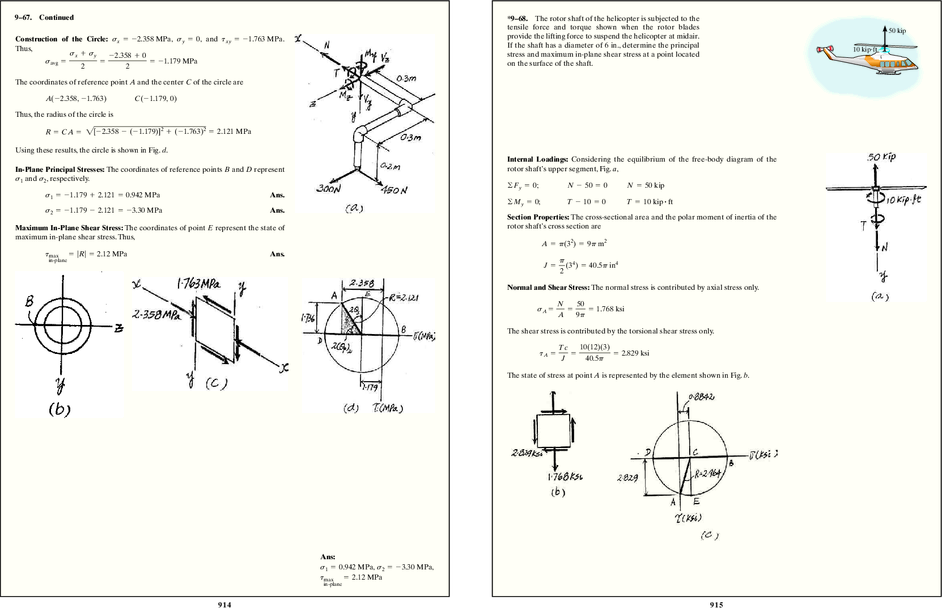

9–67. Continued *9–68. The rotor shaft of the helicopter is subjected to the
tensile force and torque shown when the rotor blades 50 kip
Construction of the Circle: sx = - 2.358 MPa, sy = 0, and txy = - 1.763 MPa . provide the lifting force to suspend the helicopter at midair.
Thus, If the shaft has a diameter of 6 in., determine the principal 10 kip!ft
sx + sy -2.358 + 0 stress and maximum in-plane shear stress at a point located
savg = = = - 1.179 MPa on the surface of the shaft.
2 2
The coordinates of reference point A and the center C of the circle are
A(-2.358, - 1.763) C(- 1.179, 0)
Thus, the radius of the circle is
R = CA = 2[ - 2.358 - ( -1.179)]2 + (- 1.763)2 = 2.121 MPa
Using these results, the circle is shown in Fig. d.
Internal Loadings: Considering the equilibrium of the free-body diagram of the
In-Plane Principal Stresses: The coordinates of reference points B and D represent rotor shaft’s upper segment, Fig. a,
s1 and s2, respectively.
©Fy = 0; N - 50 = 0 N = 50 kip
s1 = - 1.179 + 2.121 = 0.942 MPa Ans.
©My = 0; T - 10 = 0 T = 10 kip # ft
s2 = - 1.179 - 2.121 = - 3.30 MPa Ans.
Section Properties: The cross-sectional area and the polar moment of inertia of the
Maximum In-Plane Shear Stress: The coordinates of point E represent the state of rotor shaft’s cross section are
maximum in-plane shear stress. Thus,
A = p(32) = 9p m2
tmax = |R| = 2.12 MPa Ans.
in-plane p 4
J = (3 ) = 40.5p in4
2
Normal and Shear Stress: The normal stress is contributed by axial stress only.
N 50
sA = = = 1.768 ksi
A 9p
The shear stress is contributed by the torsional shear stress only.
Tc 10(12)(3)
tA = = = 2.829 ksi
J 40.5p
The state of stress at point A is represented by the element shown in Fig. b.
Ans:
s1 = 0.942 MPa, s2 = - 3.30 MPa,
tmax = 2.12 MPa
in-plane
914 9 15
