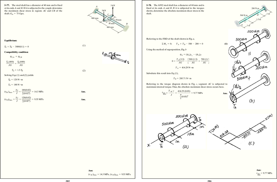

5–77. The steel shaft has a diameter of 40 mm and is fixed A 3 kN 5–78. The A992 steel shaft has a diameter of 60 mm and is
at its ends A and B. If it is subjected to the couple determine fixed at its ends A and B. If it is subjected to the torques 200 N!m
the maximum shear stress in regions AC and CB of the 3 kN shown, determine the absolute maximum shear stress in the B
shaft. Gst = 75 Gpa . C shaft. 1m
500 N!m D
400 mm
50 mm 1.5 m
C
50 mm B
A 1m
600 mm
Referring to the FBD of the shaft shown in Fig. a,
Equilibrium:
©Mx = 0; TA + TB - 500 - 200 = 0 (1)
TA + TB - 3000(0.1) = 0 (1)
Using the method of superposition, Fig. b
Compatibility condition:
fA = (fA)TA - (fA)T
fC>A = fC>B
TA (3.5) 500 (1.5) 700 (1)
TA (400) TB (600) 0 = - c + d
= JG JG JG
JG JG
TA = 414.29 N # m
TA = 1.5 TB (2)
Substitute this result into Eq (1),
Solving Eqs (1) and (2) yields:
TB = 285.71 N # m
TB = 120 N # m
TA = 180 N # m Referring to the torque diagram shown in Fig. c, segment AC is subjected to
maximum internal torque. Thus, the absolute maximum shear stress occurs here.
Tc 180(0.02) TAC c
(tAC)max = = p = 14.3 MPa Ans. 414.29 (0.03)
4 tabs = = = 9.77 MPa
2 (0.02 )
J max Ans.
J p
120(0.02) (0.03)4
Tc 2
(tCB)max = = p 4
= 9.55 MPa Ans.
2 (0.02 )
J
Ans: Ans:
(tAC)max = 14.3 MPa, (tCB)max = 9.55 MPa tabs = 9.77 MPa
max
385 38 6
