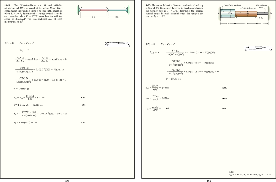

*4–68. The C83400-red-brass rod AB and 2014-T6- 4–69. The assembly has the diameters and material makeup 2014-T6 Aluminum 304 Stainless
aluminum rod BC are joined at the collar B and fixed A B C indicated. If it fits securely between its fixed supports when steel
C 86100 Bronze
connected at their ends. If there is no load in the members the temperature is T1 = 70°F, determine the average
when T1 = 50°F, determine the average normal stress in normal stress in each material when the temperature A 12 in. 8 in. D
each member when T2 = 120°F. Also, how far will the 3 ft 2 ft reaches T2 = 110°F.
B C 4 in.
collar be displaced? The cross-sectional area of each
member is 1.75 in2.
4 ft 6 ft 3 ft
©Fx = 0; Fbr = Fal = F ©Fx = 0; FA = FB = F
dN>C = 0 F(4)(12)
dA>D = 0; - + 12.8(10 - 6)(110 - 70)(4)(12)
p(6)2(10.6)(106)
Fbr LAB FalLBC
- + aB ¢T LAB - + aal ¢T LBC = 0
AAB Ebr ABCEal F(6)(12)
- + 9.60(10 - 6)(110 - 70)(6)(12)
p(4)2(15)(106)
F(3)(12)
- + 9.80(10 - 6)(120 - 50)(3)(12) F(3)(12)
(1.75)(14.6)(106) - + 9.60(10 - 6)(110 - 70)(3)(12) = 0
p(2)2(28)(106)
F(2)(12) F = 277.69 kip
- + 12.8(10 - 6)(120 - 50)(2)(12) = 0
1.75(10.6)(106)
277.69
F = 17 093.4 lb sal = = 2.46 ksi Ans.
p(6)2
17 093.4 277.69
sbr = sal = = 9.77 ksi Ans. sbr = = 5.52 ksi Ans.
1.75 p(4)2
9.77 ksi < (sg)al and (sg)br OK
277.69
sst = = 22.1 ksi Ans.
p(2)2
17 093.4(3)(12) -6
dB = - + 9.80(10 )(120 - 50)(3)(12)
1.75(14.6)(106)
dB = 0.611(10 - 3) in. : Ans.
Ans:
sal = 2.46 ksi, sbr = 5.52 ksi, sst = 22.1 ksi
251 25 2
