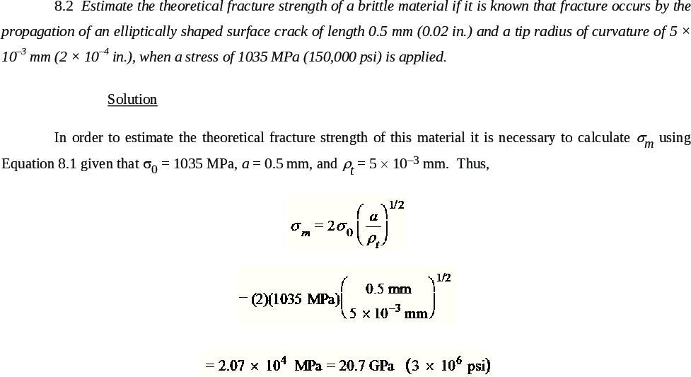

8.2 Estimate the theoretical fracture strength of a brittle material if it is known that fracture occurs by the
propagation of an elliptically shaped surface crack of length 0.5 mm (0.02 in.) and a tip radius of curvature of 5 ×
10–3 mm (2 × 10–4 in.), when a stress of 1035 MPa (150,000 psi) is applied.
Solution
In order to estimate the theoretical fracture strength of this material it is necessary to calculate Vm using
Equation 8.1 given that V0 = 1035 MPa, a = 0.5 mm, and Ut = 5 u 103 mm. Thus,
Solution
