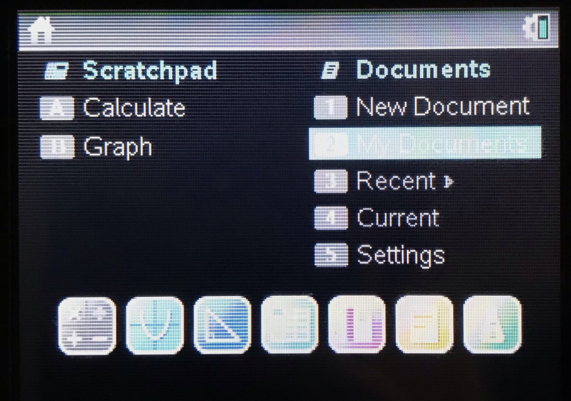

Unread postby ttn-15 » Today, 00:00
Alright, I did some more testing here and I found that when I reset the Nspire from software, such as from this Ndless program - archives_voir.php?id=1960279 - the screen issue continues in the ControlX menu, but when I use the reset button, the screen returns back to normal.
If I get the screen to be flickering from OS reset -> ControlX is flickering -> I press 0 for reset, the calculator continues flickering.
I'll attach here a photo here of what the screen looks like.
One other thing I tried to do is to while keep the calculator warm booted and in that flickering state, use nSwitchOS to install a newer v4 OS and boot it up all the way. Here I found that even when the v4 OS boots up, the screen is still flickering and washed out, even when I put the calculator to sleep.
So this definitely seems like the v3 OS is doing something wacky with the screen when it goes to sleep. And this calc is a revision C, so it should have worked fine on v3.1 with that boot2 before...
Please let me know if this would help troubleshoot the issue better.
