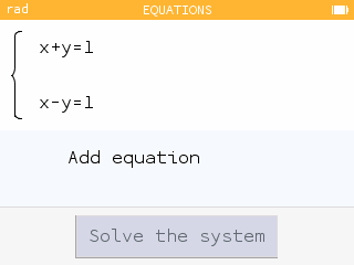

Unread postby critor » 26 Feb 2022, 11:16
You can enter several equations and then solve the resulting system of equations :
Image Image
Did you have something else in mind ?

critor wrote:You can enter several equations and then solve the resulting system of equations :
Image Image
Not at all. I'd like to have a list of many equations that I usually use and be able to pick them again and solve from the list. Also, I'd like to be able to have many variables and solve for any of them, while others are defined. Solvers in HP and Casio offer this for many years.
