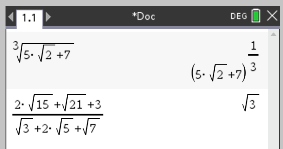

Нow to make the TI-Nspire CX CAS reduce variuos radical expressions (and whether it is capable of doing that, at all)?
like that
or more simple
I’m not talking about quite simple examples like Image, Image, but those where a bit more complex transformations are needed.

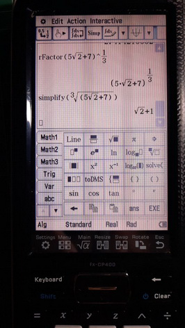

Тo make more sense of what it's about, here are examples done with other calculators:

Unread postby Adriweb » 11 Apr 2023, 12:55
Simplifications are automatic. So, whenever it can, it will do it.
For instance, it works fine on your first example, but can't simplify the 2nd one :

Unread postby bluestone » 12 Apr 2023, 08:04
And then it turns out that the CP400 has more advanced CAS if it can do that?

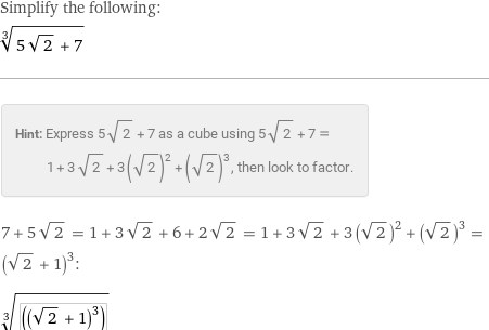

Re: Simplifying radicals on TI-Nspire CAS - it is possible?
Unread postby Hisham » 15 Apr 2023, 11:52
In some cases it's possible to simplify nested (cubic) radicals. Let's suppose we have (m+n∙sqrt(p))^(1/3). The radicand should be of the type: (a+sqrt(b))^3 = a^3 + 3ab + (3a^2 + b)∙sqrt(b), that is m = (a^3 + 3ab) and n∙sqrt(p) = (3a^2 + b)∙sqrt(b). To be able to say that b=p (the radical part is not univocally determined), we'll need to look at the various "representations" of the radical and see if there is one where (n-p)/3 is a perfect square.
In such a case, we'll have a=sqrt((n-p)/3) and b=p, hence (m+n∙sqrt(p))^(1/3) = a+sqrt(b).
Example: (7+5∙sqrt(2)) = (a+sqrt(b))^3, where (a^3 + 3ab)=7 and a=sqrt((5-2)/3)=1 (b=p=2). Thus we get (7+5∙sqrt(2))^(1/3) = 1+sqrt(2).
This procedure could be "algorithmized" (i.e. through a system) for the TI-Nspire (with TI-Basic or Python) but it does not work in all cases (generally Landau's algorithm is used for the CAS calc).
