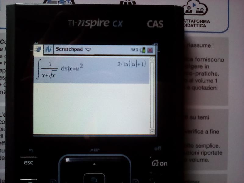

Unread postby Hisham » 16 Nov 2018, 13:56
Istp wrote:Nickel merci et pour les changements de variable, penses tu qu'il existe un truc?
Hi Istp,
you can do something like this (but … sorry … no steps):
Or … different idea … you could do the substitution manually … u=sqrt(x) --> x=u^2 (u>=0) … so the integral becomes int(2u/(u^2+u)*du) …
Now the integral can be solved (stepped) by SINT:
archives_voir.php?id=15332
