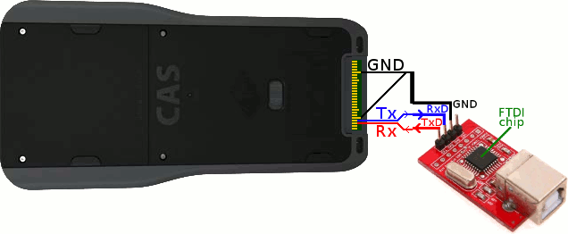

There is currently no easy tutorial to install Ndless 3.1 on your calculator in its current state.
You'll need to reflash Boot2 3.1 using an USB/TTL interface you'll have to connect to some pins of the Dock connector:
