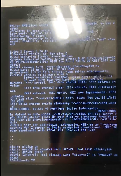

Ok, I´ve tested the new .dtb and zImage for the CXII and it worked normally with the screen rotated to the right side and even without using a powered USB Hub, just the OTG connected to the USB Pen Drive. Here is a shot of it:
You cant see with that image, but Debian loaded normally.
Now, first of I would like to ask you if you have now someway to fix the screen rotation for the CX, for testing purposes to see if it would work was fine, just take a picture, flip the image and now I can read what´s on screen. Problem is, to try to use it normally it is starting to be a pain in the *ss. I don´t mind having it in this kind of "Portrait Mode" (Sorry, I forgot the screen resolution of the X+ models), but at least having it flipped in the right side so I can read the text would be great. I know you said you can´t just solve it with software like it´s done with Ndless compatibility mode, but isn´t there anyway, at least by installing and running some linux application once it boots up the system?

SuperXX wrote:Ok, I´ve tested the new .dtb and zImage for the CXII and it worked normally with the screen rotated to the right side and even without using a powered USB Hub, just the OTG connected to the USB Pen Drive.
As long as it doesn't need too much power, it should indeed work.
Yay! How long did it take (ignoring the 10s rootdelay) and how is the USB drive speed?

Regarding the CX:
startx gives some errors when trying to initialize.
Here is another screenshot:
Is there anything relevant in /var/log/Xorg.0.log?
You might want to add the hostname to /etc/hosts here, that should avoid the errors at the start at least.

That error with the server only happened once and it was solved by simply resetting the calculator
Yes, there is content in the Xorg.0.log
Sending as an attachment
I´m also sending the .old one. I assume it is the one that happened before the last, so that´s for the successful CXII try
Ok, I´ve added it now.
