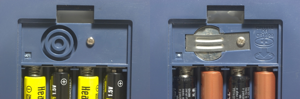

  1. The original TI-81, which began production around the beginning of 1990. As well known, these do not have a backup battery; however, these do not have a bar below the [ON] button. Additionally, the place where the backup battery should be instead contains two plastic rings (see the detailed comparisons below for a picture).
  2. Still in pre-'A' hardware revisions, the second variant of the TI-81 was introduced in May 1991 to prepare for the implementation of the TI-81 'A' and TI-85. A plastic bar was added below the [ON] button to prevent accidental presses. The backup battery's socket and labeling is present under a flat plastic cover, but there are no contacts under the cover.
  3. The third variant of the TI-81, hardware revision 'A', added a backup battery. The battery information on the back of the calculator was updated to indicate this.

5274The backup battery area. First variant on left, fourth variant on right.
