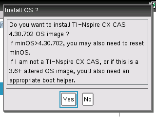

- On the calculator, just open the wanted OS file.
- nSwitchOS is going to ask you if you want to install this OS.
- Once confirmed, nSwitchOS is going to ask you if you want to keep a copy of your current OS.
Useful if you want to be able to switch back to this OS later.
But note you'll still require Ndless for this, so check Ndless OS support.
- If selected, your current OS file is moved to the documents root folder and given a version.t?? name.
- Your chosen OS file is then moved to the system folder (thus disappearing from the visible files)
- Once you get the final dialog box, press the reset button on the back to install and use your new OS.
